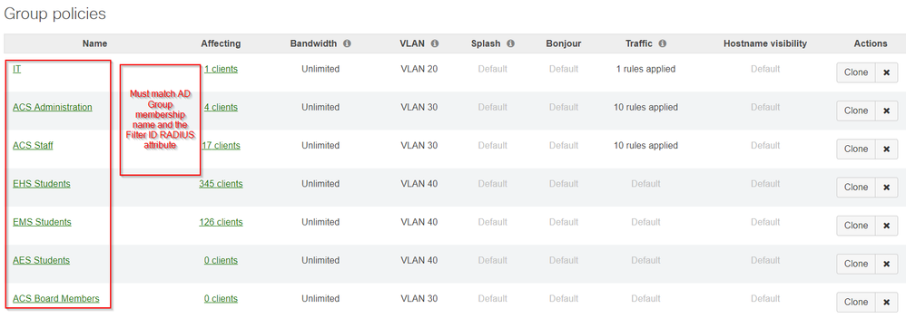

  • ACS-BYOD:  BYOD networks for staff and student personal devices using a combination of RADIUS and Meraki group policies to further segment based on AD group membership.  IT, Staff, Students, Admins all get a different VLAN up authentication.  This keeps me from having to have multiple SSID's achieving the same result.  Depending on the AD group membership, the Meraki group polices are allowing or disallowing certain network access...file servers, etc.  Filtered using framed IP address and ias logs on the RADIUS servers to tie username and IP address together thus providing the same internet filter policy as if logged in to a Windows machine. VLAN's 20, 30, 40, 50.

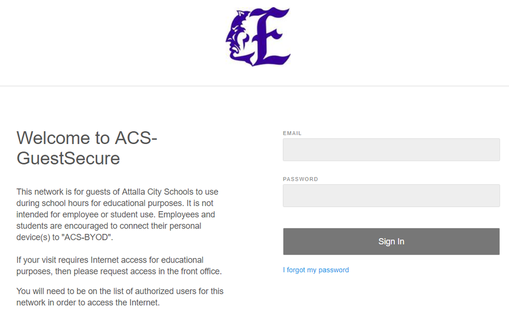

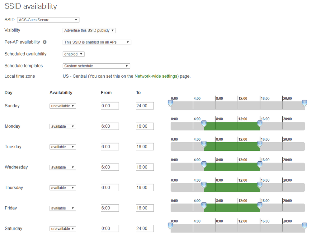

  • ACS-GuestSecure (M-F 6am-4pm using Meraki SSID Availability):  For non-employee/student visitors here for education reasons (deemed so by principal) that need wifi using Meraki splash page and authentication.  I have a guest ambassador at each site and using OneLogin SAML SSO and Chrome extension, the guest ambassador has one click SSO into their portion of the Merak dashboard to create true guest accounts as needed per the discretion of the principal.  VLAN 250 and this entire network is filtered using my internal content filter set extremely loose so that education-related visitors should have no issue during their visit.

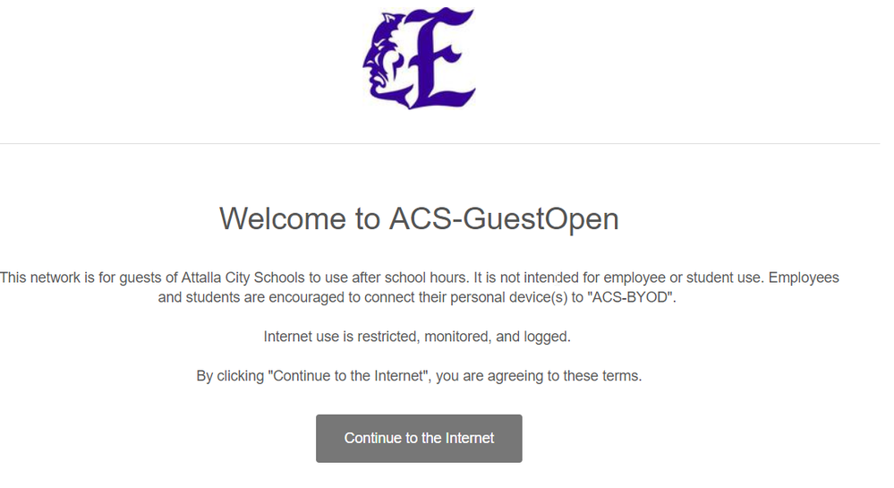

  • ACS-GuestOpen (M-F 4pm-6am and all day Saturday and Sunday):  For after hours guest wifi for anyone at any of our sites.  Meraki click-through splash page after agreeing to our terms of use.  VLAN 200 and filtered in the same method above, but with a student level filter policy since it is anonymous.
Below is each splash page followed by their scheduled availability:

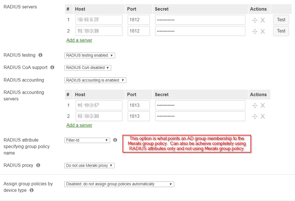

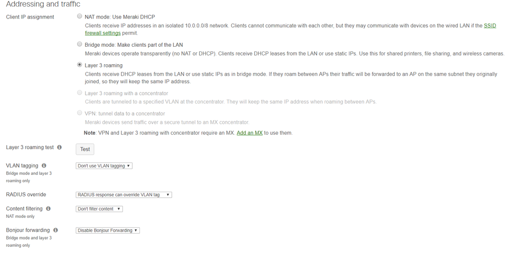

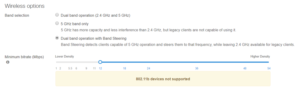

I've included pics of the settings below followed by great Meraki and Microsoft documentation on this process.
I actually have two NPS servers (just for failover purposes and no single point of failure) hearing the requests and load balancing and then three actual RADIUS server roles on three other servers processing the requests for loading balancing at (34%, 33%, 33%).
2017-12-05 09_21_33-Access Control Configuration - Meraki Dashboard.png2017-12-05 09_23_40-Greenshot image editor.png2017-12-05 09_24_30-Access Control Configuration - Meraki Dashboard.png2017-12-05 09_24_46-Access Control Configuration - Meraki Dashboard.png2017-12-05 09_26_19-Greenshot image editor.png
