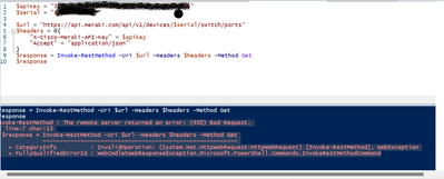

I have tried but same error below is the script and output:
script:
$apiKey = "api key"
$serial = "serial number"
$url = "https://api.meraki.com/api/v1/devices/$serial/switch/ports"
$headers = @{
"X-Cisco-Meraki-API-Key" = $apiKey
"Accept" = "application/json"
$response = Invoke-RestMethod -Uri $url -Headers $headers -Method Get
$response
Output:
Invoke-RestMethod : The remote server returned an error: (400) Bad Request.
At line:7 char:13
+ $response = Invoke-RestMethod -Uri $url -Headers $headers -Method Get
+ CategoryInfo : InvalidOperation: (System.Net.HttpWebRequest:HttpWebRequest) [Invoke-RestMethod], WebException
+ FullyQualifiedErrorId : WebCmdletWebResponseException,Microsoft.PowerShell.Commands.InvokeRestMethodCommand
