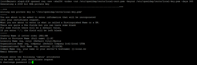

  • Create a self-signed SSL certificate, which will be used by our LDAP server. Use the following command:
openssl req -new -sha256 -nodes -out /etc/openldap/certs/local-cert.pem -keyout /etc/openldap/certs/local-key.pem -days 365
We must fill in the information as in the example below:
After generating the certificate, we will adjust the user and group permissions with the following command:
chown ldap: /etc/openldap/certs/*.pem

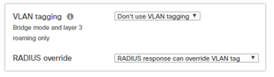

Last but not least, configure on Meraki's Dashboard, so that APs accept VLAN attributes sent by RADIUS server. On Wireless > Configure > Access Control, select the WLAN and in "Radius Override" enable the option "RADIUS Response Can Override VLAN tag".
Note: It is necessary to configure the ports on the switch where the APs are connected in trunk mode, specifying the VLANs that will be used.
