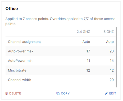

Try using these power levels.
D_Tak
You do have the ability as well to configure the RF profile in which you can lower the MAX radio transmit power range or configure minimum bitrate both of which would affect the range of signal and may stop the device from connection attempts to a farther away AP but as Karstenl stated this is a client decision as to where it connects.
More on RF profiles can be found within this Meraki Documentation.
