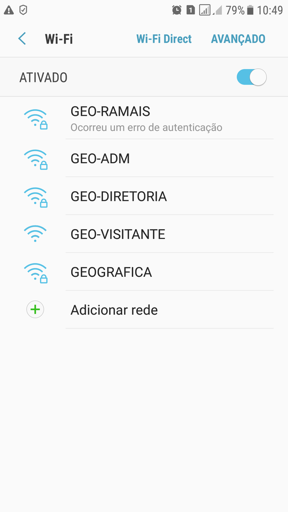

The image below will be in Portuguese because I am from Brazil the error is this:
When he accuses this error are those logs that I have sent there are some previous answers about disassociation errors.
My swtichs are branded Dell all with Vlan tags between Vlan default and Vlan 4. Communication works perfectly, IP addressing, etc...
The same problem is the scrolling and the reason for this authentication error.
When that happens we are at least a 5 minutes without connection, the smartphone gets lost does not know what it does. After long minutes he can connect, but always deactivating and activating the device wifi.
