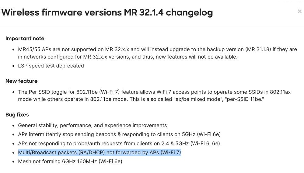

However, I'm a bit confused about this part "In my setup I can't get an IPv6 address via DHCP". Did you mean SLAAC and not DHCP(v6)? There are not many clients that support DHCPv6 and SLAAC is a preferred method of IPv6 assignment. There was a known issue with W-Fi 7 APs but it was resolved in MR 32.1.4:
It would be helpful to take a packet capture on both wired and wireless interfaces to ensure that the AP passes traffic back and forth between an DHCPv6 (if this is indeed in use) and a client.
