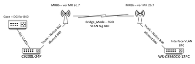

This is my topology for the bridge connection:

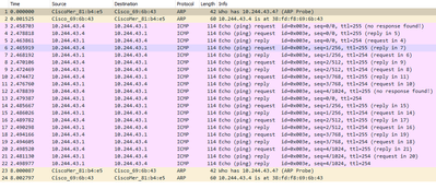

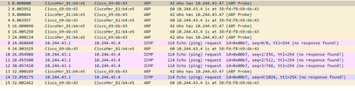

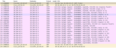

1. Trying to ping Interface VLAN 840 from Core to 3560, no response.....
2. Then trying to ping DG 840 from 3560 to core, ping success.
3. After this successful ping I can do the ping in step 1. for about 30 seconds
4. Lose the connectivity from core to 3560 VLAN interface again.....
If I SSH to device when its ping-able It will just cut me after those ~30 seconds
Any ideas what might be an issue?

The SSID tags VLAN 840, but the switch has 840 untagged?
If it was a VLAN payment problem, this wouldn't even work, wouldn't you agree?

Could you double-check the subnet mask on the 3560 please.
Martinni
Hi subnet mask matches on core and also on 3560 . /24
