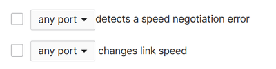

There is no email alert for an AP for this. Change of link speed is a switch port alert for the actual MS or CS switch port. do this:
On each switchport that is the uplink for the AP, add a tag. I suggest AP.
Then enable these alerts under switch and select the tag. Where you see any port, change it to  point to the AP tag on the uplink ports

Also, speed and Ethernet fall under switch alerts.  The AP is always half-duplex in the air...
Are you using Meraki Switches, if not, kind of hard to get the alerts for link speed....

Go to this link https://documentation.meraki.com/General_Administration/Cross-Platform_Content/Network_Alerts_and_No...
go the section called Ethernet Uplink Speed Degraded.
If you think there is an issue call support and open a case, you are paying for their support .  Make them tell you why.
