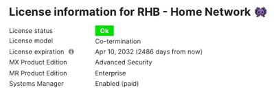

How do I check if I have that advanced licensing?
rhbirkelund
Second to the bottom line, MR Product Edition on the License Info page.
It will say Advanced Enterprise, if you have it.
VRB
We also have the Enterprise Edition, so it will not work?
