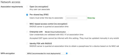

This is one of my mixed networks:
The MR30H is in the process of upgrading just now. And this is one SSID without one of the 27.x features:

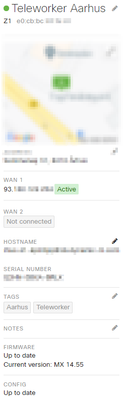

But imagine Z1 teleworkers.
The Z1 is not supported on MX15.x but you can schedule an upgrade to MX15.x. What will happen is that the Z1 will "upgrade" to MX15, but since there is not support for it, the Z1 will stay on the latest MX14.x software that supports it, but still report as upgraded to MX15.x.
I imagine that the same applies to MRs.

I think it is important to look exactly at what is happening here. It wouldn't make any sense to upgrade a Z1 to 15x, but we are not really upgrading devices. We are just setting the intended Firmware-version for a dashboard network whatever devices are in there.
And the network can easily be configured for v15 regardless if it is a Z1 in there or a Z3. But the moment the Z1 is replaced by a Z3, the Z3 will run the configured version.
