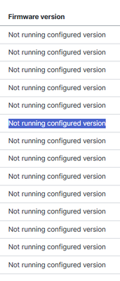

yesterday we upgraded the switches C9300L-48P-4X
Since then the switches have been showing a message
"Not running configured version"
We have rebooted and reset several times but the problem remain
Does anyone know what the problem is

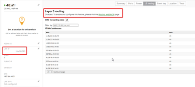

@shlomoi are they performing any L3 routing and did they have a static management IP address?
shlomoi
DHCP
NO L3 ROUTING

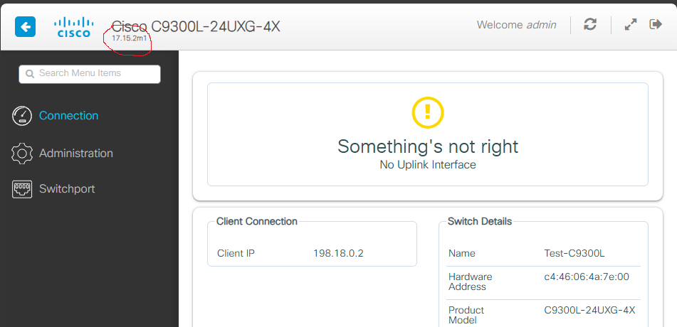

Also if you connect a cable to the management port and log in with user admin and the password from the Network/General section of the dashboard, you should see something like this that will help you see what version the switch is running and what might be the problem:

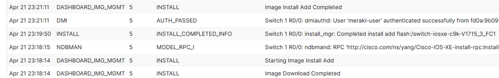

I just upgraded the above C9300L to 17.15.3 and there are a lot of entries in the event logs telling you what is happening.  I initiated the install at 22:59 and the below shows that the code was downloaded about 20 minutes later, it then took another 45 minutes to be installed, the switch rebooted and back in action:

I think it's not finishing the update.
I logged in again and it seems to still be on an old version.
cmr
It's definitely still on CS firmware.  What does the event log say?
