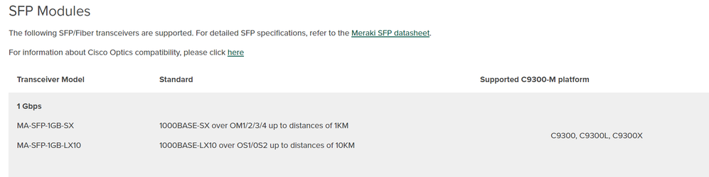

I'd open a case with Meraki, and have them verify if the optic is supported on C9300X. It's listed on the C9300X datasheet, but the switch is not listed in the compatibility list on Merakis list of trancievers.

thanks , as per attach the sfp comptabile with meraki from the other switch side , the sfp is vendor base
