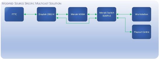

I pass Source Specific Multicast (SSM) through a small Meraki switch without issues, so I can stream encrypted 4K videos. To do this, I ensure that IGMPv3 snooping is enabled. But the MX does not handle SSM, and there is no information as to when it might. As a workaround, I have ordered a router that does handle SSM to place ahead of the MX.
Ideally, I would have just put another MS switch ahead of the MX64 and used an IPv6 address, but my ISP has not fully rolled out IPv6 , yet and there are limitations as to what Meraki does with IPv6 presently.
Robin St.Clair | Principal, Caithness Analytics | @uberseehandel
