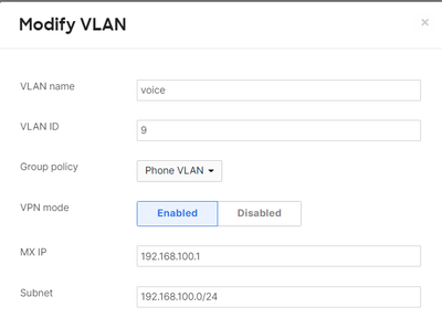

I am trying to get a set of devices to go to a specific VLAN. For some reason, even though I believe I am doing it correctly, it doesn't seem to "take affect" even after a reboot of the Meraki and the device I'm trying to assign a specific VLAN.

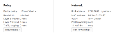

As you can see above, I have the policy set to "Phone VLAN", and the VLAN is also apart of the same group (below) On the right you will see the device is using "VLAN 10 - Default" not "VLAN 9 - voice", even though it should be through the group policy. The device in question is apart of the "Phone VLAN" group. Everything should be pointing towards overriding the VLAN its assigned to the group policy its on, but its not.
Possibly Unrelated: I also attempted to set the device to specific IP (static) to force the correct DHCP format (preferably would come from VLAN but I was just trying stuff) and I couldn't even get the device to grab the new static IP. Its like the changes I'm making in the Meraki are just being ignored by the devices, even after reboot of both the Meraki and the device I'm configuring.
