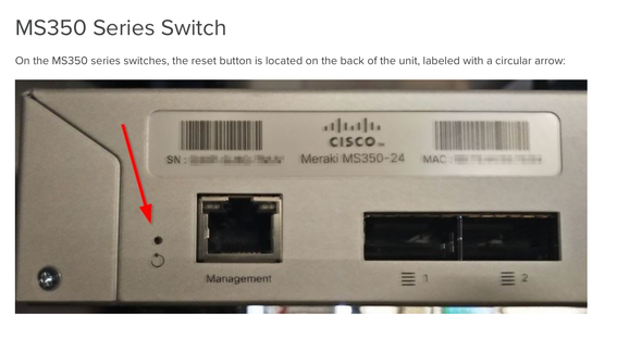

RWelch
Resetting Cisco Meraki Devices to Factory Defaults
RWelch
MS Access Switches
To reset a switch to the factory defaults, press the button labeled Reset or Restore on the front panel of the switch for 10-15 seconds. Be sure to release the button after 10-15 seconds or when power light goes out (whichever occurs first). This will clear the static IP address settings and local configuration of the device. After resetting the unit, the device will need to download its latest configuration from the dashboard. Please be patient as this could take up to 5-10 minutes.
Note: Holding the reset button after the switch reboots will place it in factory test mode. If this has occurred, reboot the device to return it to normal behavior.
RWelch
