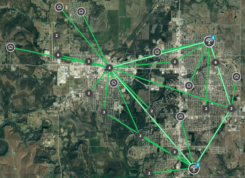

I have built a City Wide RadWin point to multi point wireless network to connect our facilities and equipment back to City Hall.
Our Water Tanks are the central locations for each sector and connect to the Phillips Building then fiber to City Hall.
We receive UDLD neighbor mismatch errors all the time on any switch that is connected to the same wireless sector radio.
Example Fire Station 2 MS120 Switch and Frontier Pool MS120 Switch each with a RadWin SU point to the same RadWin AU on top of the Phillips Building connected to a MS120 Switch then fiber down to City Hall connected to a MS425
Has anyone else built out a wireless point to multi point network using Meraki MS switches at multiple locations?
Below is an overview of the build out with a future loop if I can get the UDLD errors taken care of.
6 Replies 6
