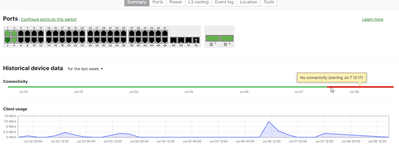

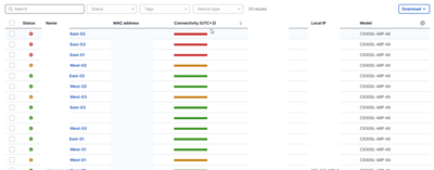

we have 3 switches in the stack that stopped communicating with the dashboard yesterday,
network is normal and there is no service disruption.
I can't find the reason, does anyone know the problem?
We have several other stacks on the same network that work without a problem.
Thanks
