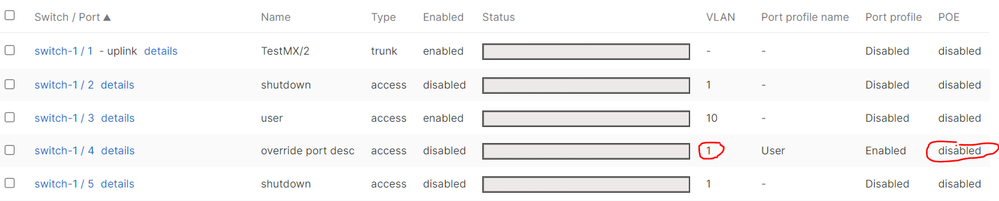

I have switchport that was originally configured in VLAN 1.
I have now applied a port profile (Early Access feature) which puts the port into VLAN 10 and enables the port.
However the Switching>Switchports screen still shows it as VLAN 1 and disabled as below:

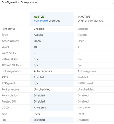

These are the original/profile settings:
I find this very misleading as the VLAN/port state is showing as incorrect as they are overridden by the port profile

RaphaelL
This is the expected behavior.    I was wrong.
It is the same behavior as SecurePort , which also overrides the port config. You only see the overrides when clicking on the port and not from the Switching>Switchports page.
I haven't tried the APIs yet with PortProfiles but with SecurePort you can get the port config and the overrides ( which kinda solve the misleading part )

Ryan_Miles
Meraki Employee All-Star
It's a known issue is a better way to put it. The goal is to have it report the correct data. Work is still ongoing.

TimHughSmith
Came to say exactly the same thing 🙂
Love the feature, but that is really annoying.
The other one, is that there is no <None> option for the Port Profile - if you were to set a profile and disable it later, the profile sticks.
So my practice so far.. (because I cannot deal with seeing the inconsistency) 🙂
- Before you apply a profile (or if you already have one, and things are out of whack)
- When you edit port or group of ports - you can toggle profile disabled, then adjust the values to what you want to see, then toggle profile on and save it.. (that will keep them looking the same initally)
- But kind of defeats purpose of profile (when you change it later, it'll be out again)
So I think best idea, is create a Default profile
Make that something that wont change. I.e. Trunk vlan 1 or whatever your standard is
Apply that to all ports + updating the non profile config as above.
Then apply your real profiles to ports.
Your values will be out of sync, but we know this, so hide them in the port list, and look at profile only (or drill in).
And any ports that have disabled profiles - you can set to Default
The issue I had with the profiles showing, means that if you filtered on profile, you could find ports that had a profile, but are not enabled now.
Anyway, they are my work arounds for now 🙂
