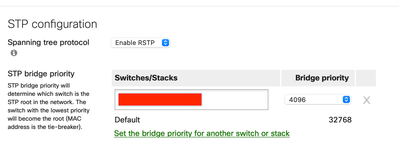

Spanning-Tree - what does your core consist of - is it Meraki?  Is it set as the lower priority to your new switch stack?  Anything showing in event log in the dashboard?
Chris_Durham
yes - core is 2 Meraki MS425-16's, RSTP is enabled on the uplink - it is enabled on all ports by default so I've just left it alone. How would I check the priority ? can't see anything about it on the dashboard. There is nothing in the logs other than the expected port up/port down messages when the test pc was plugged in and then moved. There is a message that the port STP status changes from disabled to designated when the test pc was plugged in.
DarrenOC
On your dashboard. Switch > Configure > Switch Settings
Chris_Durham
Ok - I haven't set any priority. I guess my MS425 stack should be the root of the tree and have the lowest priority then? The MS425 stack does the layer 3 routing.

Quite a big change to make during working hours on a live network but yes - make the MS425's your root.

I'm not entirely certain which of your great suggestions solved this issue but it is now working. I changed the STP priority of my main MS425 core stack to be 0 to make it the root of the spanning tree. I also put the second uplink in place to complete the link aggregation. I have tested removing each of the uplinks and it still works as I would expect it to.
Changing the STP root did change the topology map overnight to put the core stack at the root of the network so perhaps it was that that was causing the issue.
