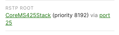

Till I have connected the switch to the DC on Vlan 912 things are working good.. but now as soon as I have connected the DC switch it took over the RSTP root role. Every testing or any changes on DC switch or that link is now causing the RSTP election resulting 15 second outage.
I do not want DC switch to be root for the site. I want Site core switch to be the root no mater what.

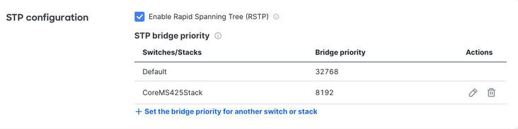

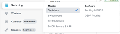

I couldn't find any settings on the site switch portal to change the priority to make it root..
Any suggestion will be good. I think the MS425 has the switch > configuration tab to change the priroty. I believe all the priority are set the default.
