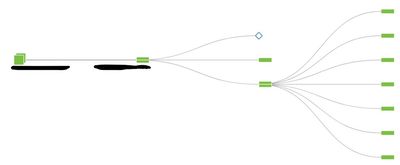

What does your topology page show (any loops)?  Can you share a pic of the topology?
What does your routing table show?  Can you share a pic of our routing table?
Can you share how you have L3 configured?  What is the next hop?  Are you using a transit VLAN?  And part of the L3 setup would include verifying your management IP addressing is set correctly.  What VLAN is your management VLAN?
Are your SFP or SFP+ or CAT6 uplink and downlinks the same (all 1Gig, all 10Gig, etc)?
Your post indicates MS425 core switches.  Are they separate core switches or stacked?  If separate, does the STP Bridge priority for the second or third one have a HIGHER bridge priority than the main root bridge?
thierryncho1986
attached is the topology,
the switch is in l3 mode, the core switches are stacked, the sfp cables are 10g they interconnect the switch cores, switch distributions and the fw
