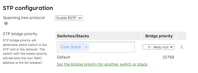

What is the bridge priority configured on your switch core:
Is the RSTP enabled on Cisco IOS switches? The ports are configured as trunk or access?
JonP
The core stack is priority 0:
The Cisco IOS devices have RSTP enabled, and the uplink is a trunk port:
