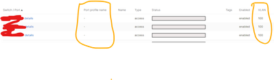

I just gave the feature a new try in brown-field deployment and it really sucks.
The buggy UI integration shows the "original"-port configuration in somewhat kind that it is really confusing for support to find out which VLAN is in use. This feature has such a great potential, but at the moment it's not my best friend.

the fact is, everything is correct in the port details, it's only in the "switchports" dashboard that it's wrong for me.
Who cares about the "original" VLAN, we want to see the configured and active VLAN! Likewise, if I remove a port profile, it is still displayed. The only workaround is to create a profile with the name "-".
I have marked this in orange.
The feature itself is great, if it weren't for these two details.

Yeah, its confusing, also if you use that for Uplink/Downlik ports without setting them manually first (lets say a brand new switch with the standard trunk + native vlan 1 setup on all ports) - the dashboard will start complaining about vlan mismatch on trunk ports (its checking against the manual setup, not the current one affected by port profiles).
