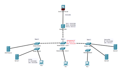

Hi GIdenJoe. Thank you for your detailed response. I truly appreciate the clarity you've provided. I'd like to offer some additional context about our current setup to give you a more comprehensive view of our goals. This should help us refine our approach and ensure we're on the right path. I apologize if this leads to any repetition from your previous answers, but I want to make sure I fully understand the situation.
Here’s a simplified version of our topology…
As mentioned earlier, our plan is to replace the old Catalyst 3560 switch and designate the Meraki MS250 as the core switch in stack 1, handling all IP routing and inter-VLAN routing. Our goal is to replicate the functionality of the Catalyst 3560 as closely as possible with the MS250.
Since Meraki devices don't use a CLI, I'm trying to understand the first steps for configuring the MS250 with all the necessary SVIs and routing. Should I first disconnect the Catalyst 3560 and connect directly to the MS250 via its configuration port? Then, do I assign it an IP address that allows for internet connectivity to bring the switch online in the Meraki Dashboard? After connecting the firewall link to the switch, can I proceed with the configuration through the dashboard? I'm just a bit unsure about this initial setup phase.
Please be aware downtime for a few hours is ok.
Many Thanks.

If the 10.0.0.253 and 254 are part of a larger /24 10.0.0.0 subnet then you have 2 options. If the 10.0.0.253 and .254 are part of a small 10.0.0.252/30 then you have one option.
First you'll have to make sure your MS250's have a management IP. If using 10.0.0.0/24 you can add them to that upstream subnet. If it is 10.0.0.252/30 then you will need a second subnet coming down from your firewall (perhaps op a VLAN on the same physical port).
In your upgrade window of a few hours you can then start by removing the 10.0.0.254 SVI from the old core and add it to the MS250's with a default gateway pointing to 10.0.0.253. And then remove all other SVI's from the old switches and add them to the MS250 stack.
This has to happen where every switch has full layer 2 connectivity of course else you will have reachability errors.

The .253 & .254 are part of a larger /24 subnet so no need to create a separate subnet on the firewall. All other switches have their management IP in this same subnet also, but their gateway is pointing to .254
So to be clear, this is all done whilst both connections are still in place. Would i put the management IP on the new core pointing to the .253 as its gateway? I can then start by removing the .254 SVI from the old switch and adding it to the new?

You must point the management of the new switches directly toward the IP of the firewall. You can never use the switch itself as gateway for it's own management IP. And if you have IP addresses to spare you can just add both MS250 stack members inside the 10.0.0.0/24 subnet. That means you will have to point your endpoints to the other IP .253 as gateway or swap both IP's before proceeding.
After that those switches will be fully online and ready to receive your SVI configurations in your upgrade window.
So both your MS250 stackmembers will have a separate management IP. But the stack as a whole will only have one IP on the SVI. Also remember when you go to the routing & DHCP page you will have to create the upstream SVI first because there will be a mandatory default gateway there which will be the IP of the upstream firewall. After that you can freely create all other downstream SVI's.

Thank you GldenJoe, you've been very helpful with your responses. This now makes sense. Thanks again for your help and have a great day.
