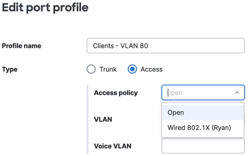

Ryan_Miles
Meraki Employee All-Star
That's supported today within the switch port profile
RaphaelL
Misread. My bad , you are right hes mentionning MAC allow list.
