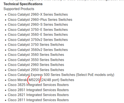

Only MS 220 is supported:

Yeah I took a look at that, but it really only references Catalyst series switches. I found some documentation shown below that seems to imply that Meraki would support that functionality via GUI, but the trail kind of dies off there.
https://www.cisco.com/c/en/us/products/collateral/switches/redundant-power-system-2300/product_data_...
I'm wondering if we would have to start implementing API's to get that sort of control.
Thank you.

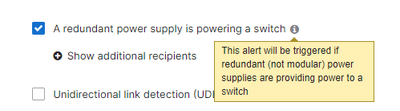

There is an alert for this under Network / Alerts in the Switching section:
