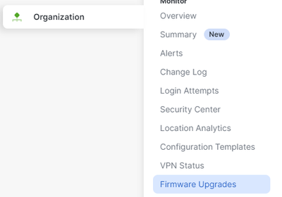

Does the Meraki Dashboard show any firmware upgrades about a month ago?
murphytb2
Comes here often
YEs
murphytb2
Comes here often
I have upgraded to the I think 16.9. MS355 switches.
murphytb2
Comes here often
Upgrading the switches did not fix the issue?
