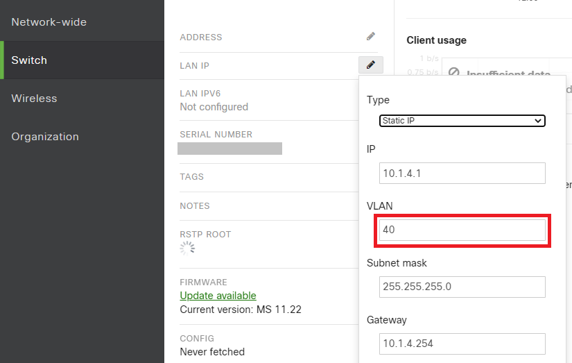

Hi there
Please can someone explain to me the function of an MS switch's management interface VLAN field (found within a switch's LAN IP settings pane):
Is it in reference only to switch-to-dashboard traffic (information the switch needs to communicate to dashboard and vice versa) or to management traffic in the sense of STP/RSTP, CDP etc
What type of traffic will the switch "tag" with whatever VLAN is specified in that field?

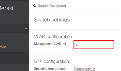

Also, is this field any different to the Network-wide "Management VLAN" field you can specify under: Switches > Switch Settings.

The network-wide setting is what every switch added to the network will use unless you override it.
The management VLAN is used to say which VLAN to use for communicating with the cloud.
https://documentation.meraki.com/MS/Other_Topics/Switch_Settings#Management_VLAN

Am I right in thinking they refer to the same type of traffic then - and this being switch-to-dashboard traffic (NOT STP/STRP, CDP traffic etc) - and just that you can override it at the switch level via that LAN IP settings pane?
Yes.
Thanks Philip. That clears it up for me (I need to stop comparing with Cisco!).
The LAN IP settings pane won't let me save settings without specifying a VLAN ID. I think it used to allow the VLAN field to be blank but obviously not any more.
Just worried about possible 'double-tagging' when specifying a VLAN ID there.. I've been told that if I want a switch to be set with a management IP address in the subnet corresponding to the native VLAN used on trunk links between switches, I must leave the VLAN field in the LAN IP settings pane (management interface)  blank. Apparently, if you do specify the native VLAN's VLAN ID in that field it will result in double-tagging?
