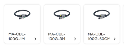

But I think the largest cable available is from 3M.
https://meraki.cisco.com/product/switches/aggregation-switches/ms450-12/
