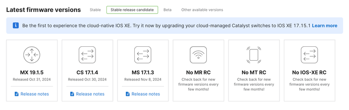

CS is 17.1.4 MS is 17.1.3.

Yep (MS 17.1.3)

Well I never said I could type right. SMH. Sorry and I can't edit now.
