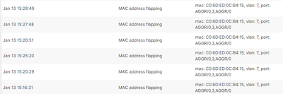

I am having this alert in MS Switch at Dashboard. Can anyone do help to resolve this Alert.
13 Replies 13
cmr
What do the event logs say?  It should show what Mac address(es) are moving from port to port.
Azar
cmr
That is suggesting that the device is changing from being seen over the aggregate ports to the local port 3.  What is connected to Aggr/0 and port 3?
Azar
Around 7 Switches the Alert came like this.

The client device is connected to wired network.
I have attached the event log snapshot here.
From where I have to start the troubleshooting
cmr
@Azar go and look at what is actually cabled to those three ports, is it a server, another switch, a wireless access point or... ?
