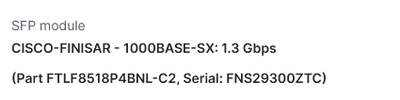

This is all I'm seeing on the switch sfp port just now. There's also a DOM warning but I think that's because the cable isn't plugged in.
From what I can tell this should also be compatible with the SFP port on our MX85. When I check the MX I'm not seeing anything in either SFP port to tell me there's a module plugged in and I can't remember how it's been left.. Maybe the issue is there. It'll have to wait now until I can get access to the comms cabs.
Everything seems to be working properly on the switch.
