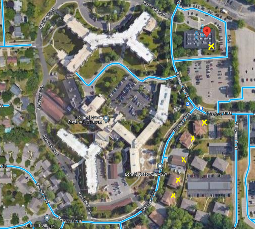

Good morning.  We have 5 buildings on our campus that we are looking to connect to our corporate network.  The primary connection from the main building to the first will be some kind of Ubiquiti point to point setup.  The distance from the main building to the first is approximately 275ft and there is clear line of sight.
From there we are going to be directional boring between each of the five buildings and installing conduit to run fiber between each location.  At each building we will need probably 8 ports max.  A video door entry system, digital signage, a couple of security cameras and badge access system.
My initial thought was to install something at the first building with enough SFP ports and home run the fiber from each building to the first building.  I believe I would need 5 ports total.  One for the Ubiquiti hardware and then a connection to the remaining 4 buildings.
Another thought was to daisy chain each of the locations.  Might be a little cheaper with shorter fiber runs between each building.

Yes, this will be a long-term solution.   User requirements are very minimal.  These buildings are independent living apartments.  Each tenant is responsible for their own internet service.  We are bringing each building online for video door entry system, digital signage, a couple of security cameras and badge access system.
I brought up the idea of a leased line to each of the locations or at least one location and then connect all 5 buildings to it but that was rejected.  They did not want to have an ongoing monthly cost.  P2P use was already in place when I came on board at a different location, and I'm told it has proven to be quite reliable for our needs.

I've been told we have hired a company, and they will be directional boring between the five buildings and installing a conduit.  Then the plan as of today is to install a pre terminated fiber between the buildings.
I understand the daisy chaining isn't ideal from a failure standpoint.  Some of this was prearranged before my involvement.  I'm just trying to execute the plan.

We have no service to any of the buildings currently.  I've been told they do not want a monthly bill x5 locations.
