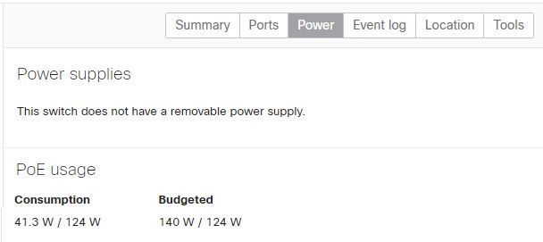

See attached screen shot.  I have a compact MS220-8P switch running 7 PoE devices all the time (MV cameras and MR APs).  Looks at my "Budgeted" section, it says 140W/124W.  That's showing that the switch max budget is 124W of PoE power, and those 7 devices (at max power draw) would take 140W.  That's because 2 of my devices are an MV72 and an MR52 both of which negotiated 30W, and the other 5 devices negotiated 16W, so there's the 140W number.  It rounds 15.4W to 16W when doing this to err on the conservative side.
But notice the consumption tends to hover around 41 to 45 watts.  Will that fluctuate?  Sure.  I don't watch it that closely, but I've never seen it over 60 watts, not even halfway to the max the switch can deliver.
