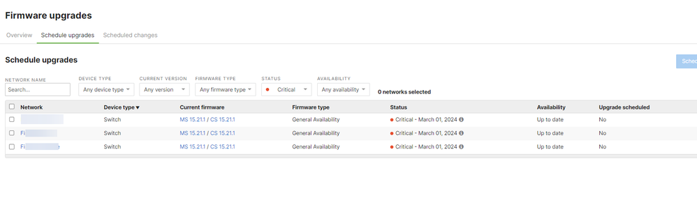

I noticed that on Organization -->  Firmware upgrades, i see under Schedule Upgrades that i have a few Critical.
I guess i should upgrade them all.
My questions are:

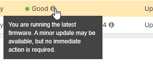

1. Why do i see on the right side "Availability"  as up to date?
2.  Should i just schedule all of them to install at night?
Not sure why it didnt upgrade automatically...

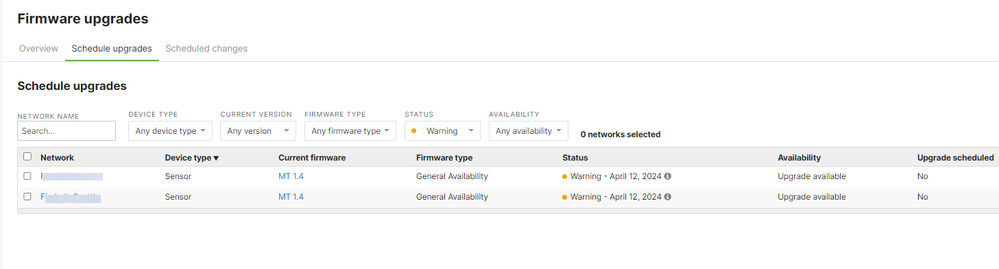

Moreover, what are those sensors..?
should i upgrade them as well?

As for sensors, if you don't have them you have nothing to worry about, meraki provides 5 licenses for free if I'm not mistaken.
Probably you have some scepter combined network?

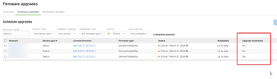

The thing is, i can see that the upgrade is not scheduled ... which is weird..
Indeed I dont have any sensors, so good I will disregard it.
But as for the switches, I`ll schedule the upgrade to happen at night (for a stable version of course)

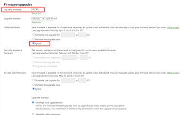

in general I do the settings to install it automatically and at night. But it depends on your needs and when most likely the network is not as much used.
Network-wide => general => firmware upgrades you can make your setting for automatic update (Update window and per device typ what time)
You also can ignore it.
In your case, maybe the upgrade window was not reached and therefore no automatic upgrade.
Do you have sensors in your network? If not, ignore it.
If you want to know more about sensors check out this:
https://meraki.cisco.com/de-de/products/sensors/

First, it seems like the switches firmware upgrade is set to Ignore.. dont know why, but i will set it to upgrade at night  (that`s probably the reason why the switches didnt upgrade...🙉)

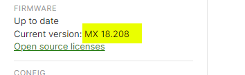

BTW, the BETA section is not enabled.. so not sure how the MX got itself to the beta version you said..
weird
Should i Make sure all firmware are scheduled to be upgraded, right?
RaphaelL
Your MX version is not a beta version. It is a Stable Release Candidate

Any idea why I have the option to upgrade the MX firmware to the same version?
I`m already running the 18.208..
RaphaelL
Because 18.208.0.1 is out
