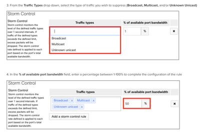

Enhanced Storm Control
What are considered "best practice" thresholds for each (Broadcast, Multicast, Unknown unicast)?
Any ports that one would not want to ENABLE storm control on or for (i.e, specific device/endpoint)?

@KarstenI @cmr @PhilipDAth - thank you for your feedback.  I have never enabled any Storm Control features or settings from the Switch Settings page but when selecting "Try New Version" at the top RH corner, there is now info listed under Storm control section of the UI.  When I revert back to the "View Old Version" it lists nothing.  I have not enabled it so it isn't impacting anything but the new page makes one think it's been configured.  I am not so fond of the new UI page so I plan to stick with the View Old Version.
