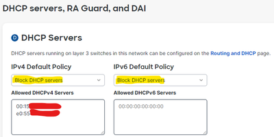

The last time I saw this happen it was mis-configured DAI.  If you have this enabled you could consider turning it off - or making sure you have every trunk port and ports to a device with a static IP address marked as trusted.
https://documentation.meraki.com/MS/Other_Topics/Dynamic_ARP_Inspection

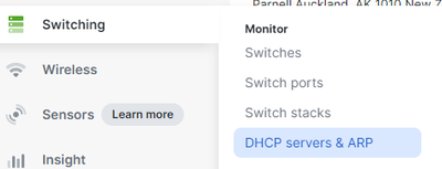

These kinds of blocks are also reported under Switches/DHCP Servers & ARP.
You could also consider if you have a DHCP block/allow list configured.
I guess you could also check if you have applied any switch ACLS.  Then there is adaptive policy, upstream firewall rules, DHCP and DNS server issues, ...
