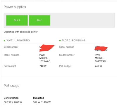

It appears from the below that adding a second power supply does not increase the PoE budget, this was previously mentioned in a 2018 post regarding an MS250 but is still the same today for an MS355:
Does anyone else agree that is would be better that the additional (not cheap) PSU was used to increase the budget, or is it just me?

Thanks @PhilipDAth , running 12.32 and now works 👍

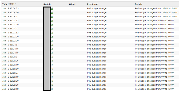

As a point of note 12.32 seems to have a bug where using combined power issues an event each minute abut the PoE budget 🙄  Reverted to redundant power and no more events after one correct entry per switch.
