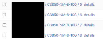

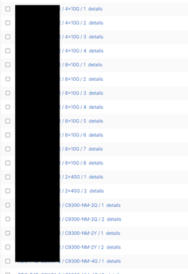

I have a stack C9300-24UX-M switches. Currently each switch has an 8 Port 1/10G SFP Fibre Uplink Module Installed (C9300-NM-8X-M). When I hover over the 8 Port Module p via the switching/switches view it is obvious that the ports associated to this 8 port module are named C9300-NM-8X / port number.
The strange thing is there are additional ports on top of the 24 Copper Ports that are displayed but don't relate to any hardware. Even referencing 3850 devices? (See screenshots) has anyone experienced this is this a bug or issue with the 9300-Ms?
Thanks

The document explains why I am seeing all possible network Modules.
"By default the Switch Port list page will show all possible module ports per Switch regardless of if the module is present"
Think everyone would agree that this is far from ideal, appreciate you can add filters but hopefully Meraki will resolve this in the future.

@Pwellion wow, I did some testing with C9300-Ms but had to RMA them for MS355s before I'd got as far as the modules.  That isn't at all friendly.
@Ryan_Miles is that definitely supposed to happen?  I can understand and 8port module showing up as 8x 1Gb ports and 8x 10Gb ports as I've seen that in IOS-XE, but showing all the possible modules seems a bit odd!
