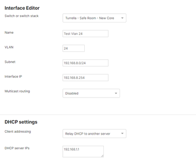

This may be a dumb question but I haven't got any confirmations yet. Can Vlan be created on Meraki Layer 3 Switch?
I have a MS225-48P Switch, it's saying this Switch is a Layer 3 Switch that can do DHCP-Relay. See below for example I create an Interface for Vlan e.g.24 but his Vlan 24 is not created on MX Firewall. If I apply this interface setting on this Vlan, will this Vlan be created and existing on the Network or not?

Hi @DarrenOC , Thanks. Let me describe what I want to achieve on MS225.
I want to create a new Vlan e.g.24 by creating an Interface on MS225, and setup a DHCP Relay to MX Firewall. On MX, I setup a Static Route to go to Vlan 24 Subnet via the IP of MS225, and I Enable DHCP on this Static Route with the Gateway of the Interface created on MS225.
Vlan 24 is not created on MX, I want this MS225 to create Vlan 24 and apply DHCP Relay to MX. Is this logic correct? Any issues?

Sounds fine,
