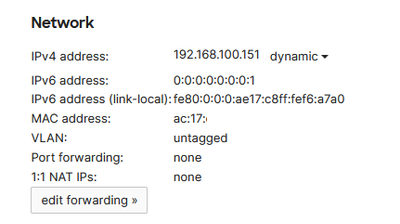

Hi.  thanks for answer.  Given that this is a public forum, should I provide the serial number to support (where I still have a ticket open) and ask them if they can tell which VLAN it is on (since I cannot see anything about the device and have NO documentation from the guy who is now on leave).  Will support be able to tell me which VLan it is on with the serial number?
Here is all I can see with it being in the "clients" area:

You can send me a private message through here with the serial and I can check
