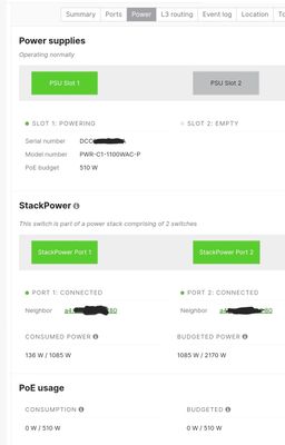

When the data stacking cables were connected the switches rebooted, formed a stack called stack - 2 (there was already an MS stack in the network) and now the power stacking correctly reported ports up on both switches and power sharing across the stack.  Interestingly, even though each switch has an 1100W power supply, there is only 510W of PoE available:

Only 510 PoE budget instead of 740?
rhbirkelund
Yeah, and this is not isolated to Meraki only.. It's actually a Cisco-thing.
You'd expect that adding N switches you'd get N times PoE capability, but not exactly..
https://www.cisco.com/c/en/us/products/collateral/switches/catalyst-9300-series-switches/white-paper...

Today, power stacking testing:
We removed the power cable from one switch and as expected the stack continued to be fully powered from the remaining power supply.  An excellent feature that I wish the MS switches would have!
The power stacking light on the front of the switch with the active power supply changed from solid green to solid amber to indicate that it is now critical, whilst the light remained green on the other switch.
On the dashboard, the StackPower figures adjust as expected, but the PoE budget and usage figures go a bit AWOL!
On the switch with no connected power cable, the numbers all adjust as expected:
Another quirk is that if you have MS and CS switches in the same network and flip between them, the StackPower section of the Power tab does not show unless you refresh the page.  I don't know if this happens in CS only networks.
