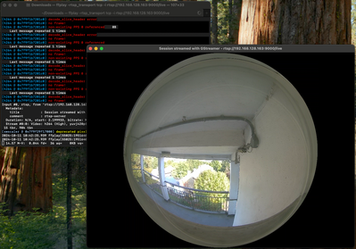

./ffplay -rtsp_transport tcp -t rtsp://192.168.128.163:9000/live
After a lot of text, it should spawn a new window and show you your stream:
If you've got this far, you've done the hard work. You can close the video window, which will terminate FFPLAY

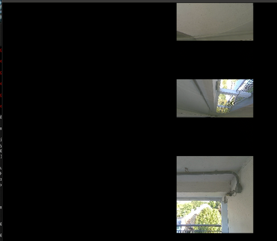

(I've only grabbed part of this image because it's 1056x6336 resolution

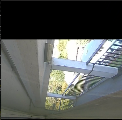

Now, the hard part. We can use a parameter in FFPLAY to both crop and rotate the image if need be
I'm going to chose the middle part of the image above and rotate:
./ffmpeg -rtsp_transport tcp -i rtsp://192.168.128.163:9000/live -vf "v360=fisheye:output=c1x6:ih_fov=180:iv_fov=180:pitch=-90" -f matroska - | ./ffplay  - -vf crop=800:800:1600:800,transpose=1
-vf crop=800:800:1600:800 takes the image at 1600:800 and creates a 800x800 image from there

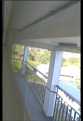

 using the transpose=1 rotates it 90 degrees clockwise with no flip we get
 Now, this is not the central part of the original image, it's actually the left hand side, but it's dewarped!
The difficult part ahead of you now is understanding which part of the image it is you want to see using
You'll only need to change the last two parameters to experiment
