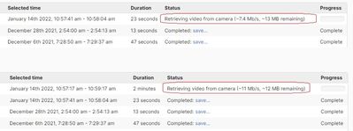

Hi @Cagg I wouldn't be too concerned, I think you're referring to the brief throughput and remaining file size status message when exporting video from a camera, like in this attached image. I tried a couple quick ones and got 7 and 11Mbps.
That is not necessarily showing that the camera itself is exporting the video slowly, but I believe is an overall rough average that would include multiple factors, including the throughput of your camera's control plane connection all the way through Dashboard as well.  Sure 1.1Mbps seems a bit slow but there are many variables including things external to MV and Dashboard itself.
Sort of like when you run a Dashboard throughput test from the Tools tab, like for a wireless AP, that is not meant to reflect the throughput capability of the AP or serve as a speed test, but just to show there is an adequate control plane connection to Dashboard.
The cameras themselves have pretty high-end processors (since they perform advanced analytics as well) so your MV72 should be connecting at 1Gbps full duplex and the chipset is certainly capable of putting more than several Mbps on the wire.
I'd say try this at different times on different cameras and if this seems to be consistently slow across the board - or perhaps just the opposite, if you find only a few cameras that are much lower/slower than most others, let's get a case open to investigate a little deeper.  Also check the wired connection itself, run a cable test, check to make sure there's not a duplex mismatch for example.
