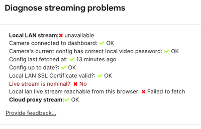

Hi,
I have a MV63 in my network and it uses a ethernet cable connected to my fiber router and get DHCP IP from the router. It streams slowly like 15 sec later than real time and it cannot switch to direct stream. I ran a diag. And it's unavailable. I wondered if switch to direct stream would help stream faster.

Livestream is for on network connections, if you are on another network then you have to stream via the cloud.  Or are you local, but just on another VLAN?

cmr
What is the camera plugged into, is it a switch that can cope with multicast?  Are you on the same VLAN?
RobertChiang
My camera is plugged into a LAN port of a fiber router.
cmr
And are you also plugged into the same router?
RobertChiang
No I’m in the other network. I remote control my camera via Dashboard.
cmr
BlakeRichardson
There is always a delay even with local stream. I find the delay is 5-10 seconds usually. Cloud stream is much higher.
If you want instant try RTSP otherwise you might need to look at other options.
