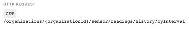

The API enables you to return sensor readings sorted by timestamp, interval, or latest reading. See below for example HTTP requests.
