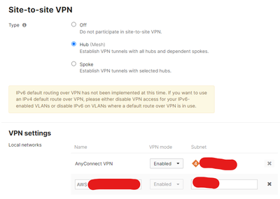

I deployed vMX and can see those online in dashboard as well, received public IP (Seems this is Natted IP, correct?) anyways bringing up vMX seemed to be really the easiest part. Now trouble starts from here. Client does not want me to setup eBGP peering between vWAN hub and vMX but deploy S2S VPN (Non-Meraki VPN Peer) between vMX and VPN GW attached to vWAN Hub.
1. I have setup vMX in passthrough mode.
2. I have configured local subnet as /24 VNET dedicated to SDWAN
3. I have configured public IP of VPN GW, then configured private subnets inclusive of test service subnets, vWAN Hub subnet.
4. I have also configured IPSEC policies to match with Azure VPN GW.
More or less similar things are done from VPN GW side, Client has configured WAN IP of vMX as remote IP and SDWAN /24 subnet as private IP...

Now no matter what I do, VPN fails. It keeps showing red signal in front of vpn peer. I ran packet capture and I was surprised to see no activity related to S2S, no attempt to setup tunnel, any initiation or failure is observed. Its complete radio silence as long as S2S is concerned. Not sure why is that?  I tried to generate ICMP traffic between two vnets by creating test VNET in the hope IPSEC will try to ride on that interesting traffic but no.
One thing on azure side - no route table is configured - per client it is not required. .
What could be going wrong here? Why there is no attempt from Meraki to even initiate IPSEC tunnel ? Any guesses guys ?
