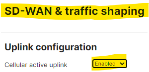

I *think* (I might be wrong) if you use this option and set the cellular to always be enabled the issue will go away.  This will mean the cellular is always connected.
Ryan_Miles
Meraki Employee All-Star
I've tested that and it doesn't appear to change the yellow icon issue on the Org overview page for a MX operating on cell
