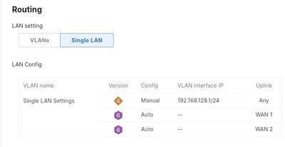

cmr
If you want traffic to move between the VLANs and don't have another L3 device doing this, then you will need to enable VLANs under Configure/Addressing and VLANs:
Disabled looks like this:

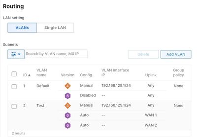

If you enable, you can then add another VLAN:
Note how IPv6 was disabled on the default VLAN when doing this... 🤔
