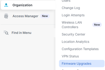

Has there been any recnetly applied Meraki MX firmware upgrades?
